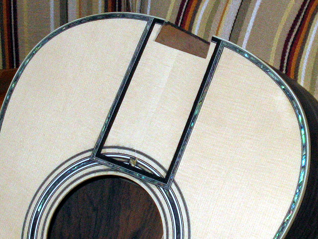

One Sweet looking guitar Jimmy, love the shape and the inlay job is superb!
Awesome!
PostPosted: Fri Dec 15, 2006 3:24 pm
Jimmy I avoided cracking open this thread for fear it was another raging debate as to the appropriateness of using jigs, fancy power tools and pre-made parts vs. the value of learning your chops using traditional hand tools. Phew glad I cracked it open.
That is a seriously scary good looking retro. I have played but a handful of few vintage Martin's and Gibson's and too was shocked at how light they are and how good they sound. I'd love to see what you have done.

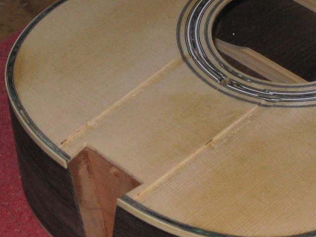

I think it was Don who commented on the need to use a dovetail joint. Why? Unless it's just part of making it a true reproduction?
By the way dovetails aren't difficult - just a little more figety when aligning the neck and flushing the cheeks to the ribs.

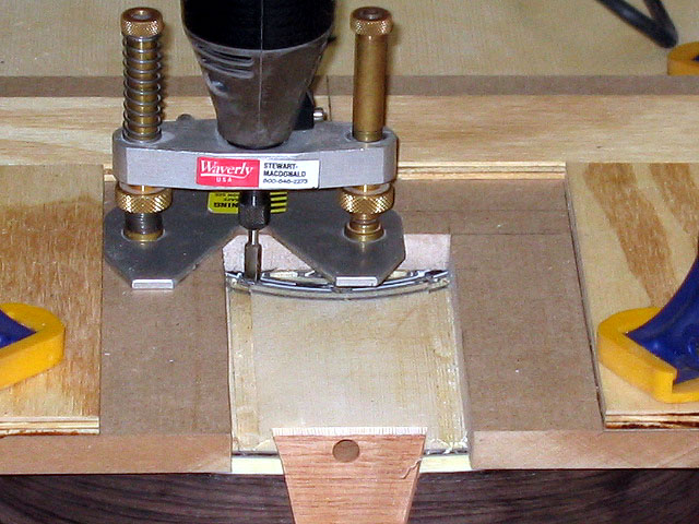

I too would love to see your jig that Tony Karol asked about.
Thanks for posting and glad I opened the thread -- please show us some of the progress pictures.

Thanks, Jimmy. I was recently wondering what was going on in the Caldwell workshop, and now I know--magic!

Anthony,
If you're building these things as Martin reproductions, then there are a couple reasons for using a dovetail. One is that the skinny heel of the Martins makes using the mortise and tenon a bit tougher to do. It could still be done if you're not going for an exact replica. The other reason, and perhaps the one more economically driven, is that the folks who buy the reproduction vintage stuff (mainly collectors) demand everything look and be as faithful to the originals as possible. In short, they demand dovetails. You could make most of it with a cnc, and they would pretty much accept that, but it's got to have a dovetail! Go figure.
They also look for things like triangular linings and such details that scream "Vintage Martin". And don't even think about using a non-Martin shaped headstock! That's practically Blaspheme.

That's an absolutely stunning little beauty! What's in store for fretboard and headstock inlays?

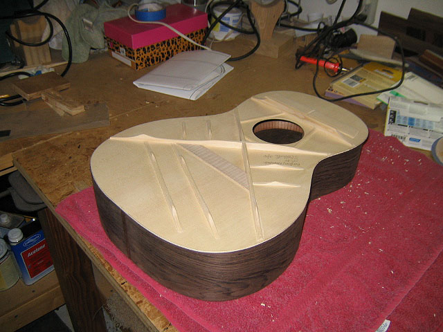

For those who wanted more pics, here are a few more. I don't have a pic of the top after I finished shaving the braces to their final profile.They came down quite a bit from the profiles in this picture. The FB extension jig is just a piece of 1/2" MDF with 3 pieces of plywood placed so that my dremel tool cuts the correct outline. I will say this this is rather exacting work because you only get one chance at this. Do a practice run on a scrap. It's particularly important that you keep everything exactly on your centerline during all phases of construction. If you don't, the FB extension inlay will show it. There's just no room for error. Someone asked about scale length and it's 24.9". I'm setting this one aside for a couple of weeks, as I've got three others to finish up.

This is a stunningly beautiful guitar. Thank you for posting the photos of the jig and the bracing.

I noticed the hole in the heelblock.
I presume for a truss rod.
SO... are you using a vintage truss rod?
Thanks for the extra pics. Really nice looking.
